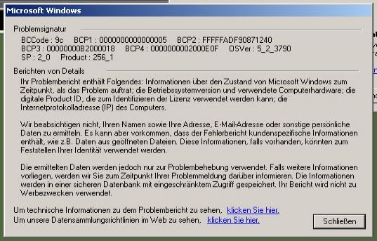

Interesting for me is, if I let start manager and server per "autostart" at slave1, than I see an error message like the attached. If I start the machine without server and manager and manualy start manager&server, than I don't see the message. Yesterday I have seen a start error message at slave3 too, today not, but the server crashed today too.
So you mean autostarting the manager and the server on Windows startup?
Right, I copied the link symbols (I don't know the right english name of the WINDOWS symbols) of both to the autostart menu entry.
This shouldn't be a problem as I do the same here without problems. Do you use any other resident software like an antivirus or firewall which scans startup applications on load? Have you tried doing this only for server but lunching the manager manually?

There is not antivir software on this machine, but today I copy the start entries for manager and server at the "autostart" for tests again and it works - no error message. :?: :? :D
